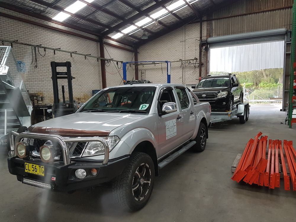

About a gear ago I got rid of the 3l lemon of a GU, I needed something more reliable and suitable for work and ended up with a V6 Navara.
It did the job and with a set of A/T's 2inch Lift and a Bullbar was managing to still get me to the usual camping and hunting spot (and recovered a few hiluxs :p.
I was starting to get sick of not being able to go on any of the trips with my mates as the Navra sucks offroad and it's critical for my business to be reliable so it was decided a dedicated Tow/4wd/hunting vehicle was needed so the Navara could stick to work duties. Picked up a 1996 GQ RD28
