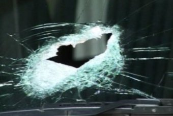

Hi mate
If you Google tow ball kills ,sadly there are plenty of examples...
Woman killed in freak towing accident - ABC News (Australian Broadcasting Corporation)
