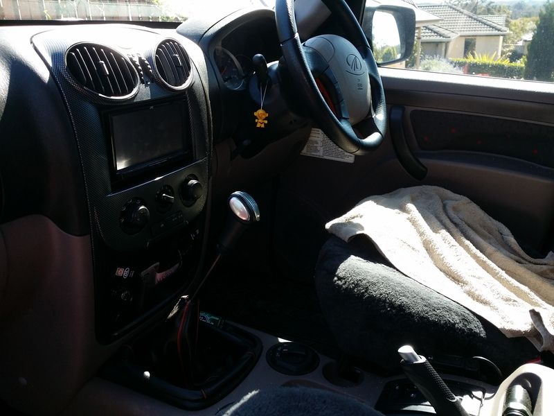

well this is my truck,
2014 pickup ,
mods,
*factory bulbar and snorkel,
*240sx flares, front suspension wound up , rear spring reset to match ( but have sagged),
*265/70R17 mickey thompson atz's on custom drilled allied 17/8.5 rims.
*modified and raised sump baseplate, custom fuel tank bash plate,
* 40L sub fuel and 40L water tank mounted under tray with pumps.
*custom undertray toolboxes behind rear axel
*L.E.D spot lights front and work lights on head board.
*UHF radio and custom stereo with dvd head unit , morell speakers in front doors and focal in the roof, twin 13i slim line subs behind rear seat.
*under bonnet duel battery system and extended diff and gear box breathers.
