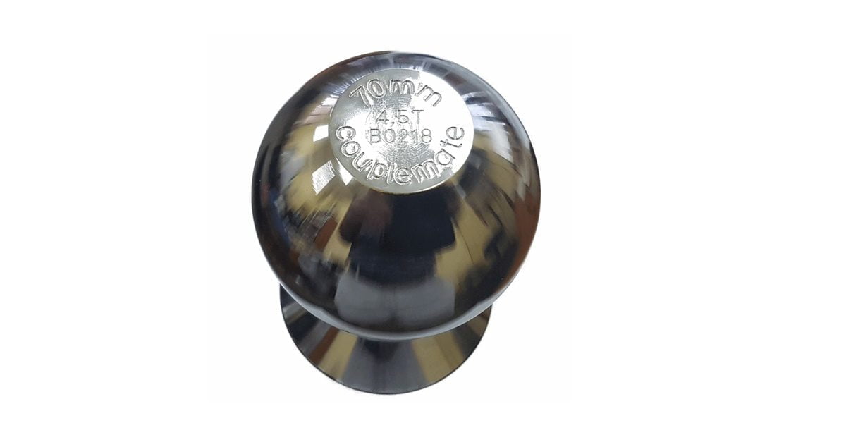

It's not difficult getting towing components that are engineered for 4.5t.
So lets work backwards, and upscale every component, by that percentage, in the tow rig, then buy new couplings for out recycle run trailer[6x4] our yacht trailer also 4.5 ton.
or we could just use Pintle hooks and and lunette's. :cool:
Yeah, but your 4.5t ball is designed for a 5th wheeler type hitch.
Using it on your standard style tow bar, even with a conservative ball down load would have close to 400kg on the ball. That's not going to affect handling much at all :oops:.
Yes and no.
I'm discussing the "no".
Well, on the vehicle in question, If I read your comment as sarcastic, we agree.
Depends on the vehicle. Our Sierra is rated to 6.5t on the towbar, and we tow a 4.5t van on the towbar.
No negative impact on stability at all.
Your estimate of tow ball mass at a "conservative" 400kg is way off the mark though. With a 4.5t van we are at about 270-300kg tow ball mass.
Thats all good, but the base vehicle in this instance is a Pajero that came from the factory with a 3000kg tow limit and restricted to a ball weight of 180kgs.
Chatty
But your comment was a general one about using 70mm balls on tow bars and stating that 70mm balls are only for 5th wheeler use.
This is blatantly wrong.
You will also see that I have already posted about the ball weight issue on the Paj.
