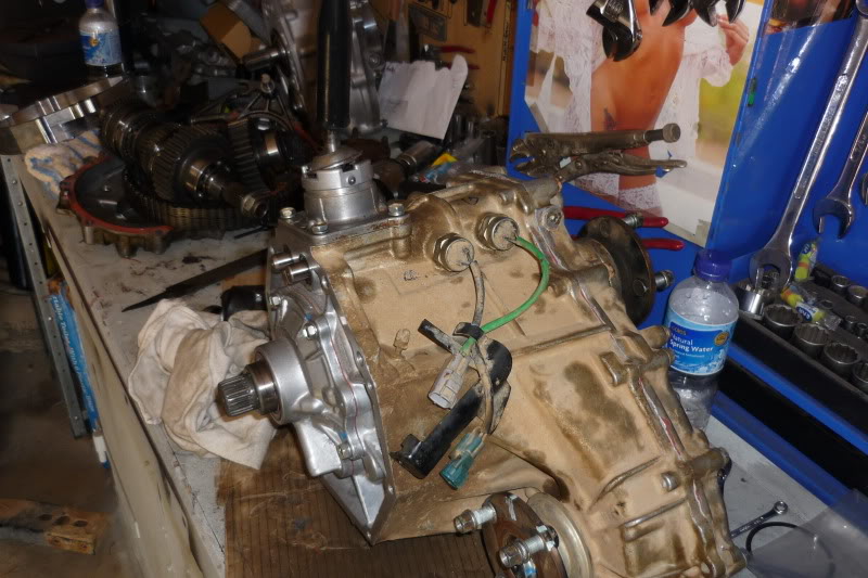

    Heres is a picture of the one of a kind transfercase.......the shift lever is just sitting there, the final shape of it is completely different. You can see the much shorter front selector shafts on it now and the higher base mount for the shifter itself.
    [​IMG]
    We mounted the incorrect adaptor plates back onto the crawl box and then bolted it to the factory transfercase, then we mounted it up in the vehicle so we could at least measure up the position of everything and get to work fabricating the crawl box shift lever so it works properly because the top of the crawl box where the shift lever exits sits below the transmission tunnel just behind the front cutout for the factory transfercase shifter when in standard configuration.

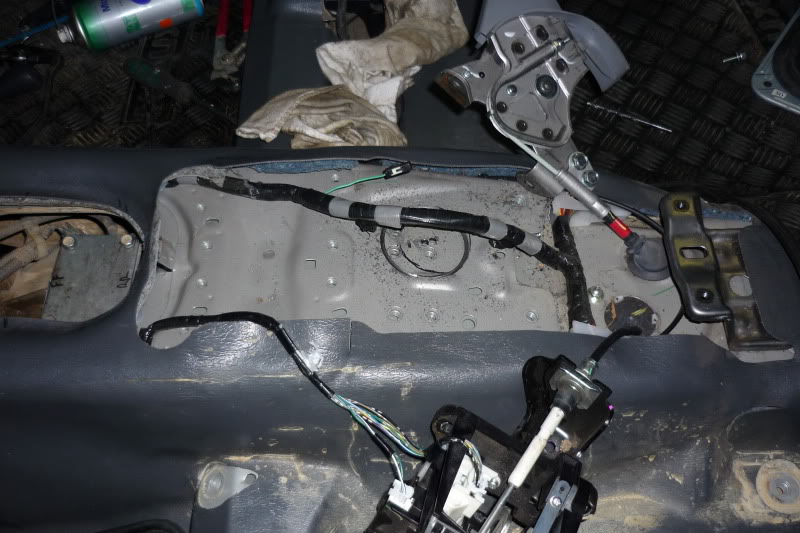

    Heres a pic of Wyatt extending the wiring under the vehicle -

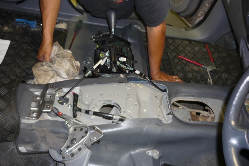

    Below is the shape of the Crawl Box shifter that Marlin and myself were working on whilst Wyatt was doing the wiring....this isnt the final product but is very close to it...it still needed some adjustment.
    [​IMG]
    The open hole that you see in the pic on the transfercase is original forward shift opening that is on the adaptor plate for the transmission...this is the one we converted from and will not be using. On the top of the pic you can see the factory allumnium cover that we were using to cover this hole, but due to the shape of the shifter we needed to make, this was too high as when we shited the Crawl Box into Compound Low the bottom of the shifter was hitting the top of it....we removed it and made another cover out of thin plate steel a dn used that instead, gaining a good 10mm of extra clearance.
    At the rear of thefactory transfer case hole that you see, we had to cut out a little piece so when the Crawl Box shifter is in High Range the shaft of the shifter will clear.

    We then removed the hand brake assembly, the auto shifter assembly and from underneath the hilux we lowered the transfercases and marked the center point on the transmission tunnel where the factory transfercase shifter will be exiting upwards in its newer location.
    We then removed the factory transfercase from the back of the Crawler, and drilled a pilot hole from the bottom upwards.
    We then jumped inisde the hilux and with a bloody expensive holesaw, (120 bux for a 3" holesaw for metal plus the drill fitting....nice, for one bloody hole! :eek: ) and drilled downwards......

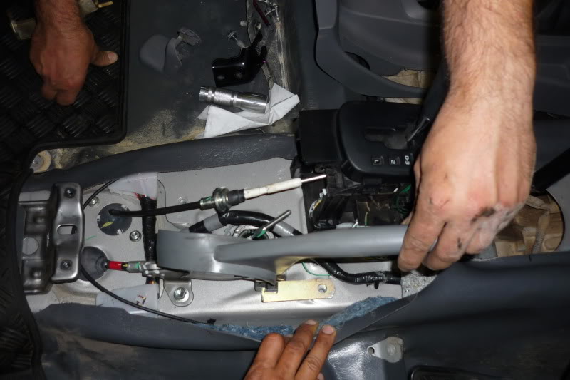

    Because of the location of the hole we drilled, the front mounting hole for the handbrake assembly had been removed......
    [​IMG]
    So I had a predrilled piece of steel that we cut and adjusted to fit and Marlin will weld it on to the frame of the handbrake assembly tomorrow. Aswell as this, the right hand side of the auto shifter bracket had to be removed to allow more clearance.....
